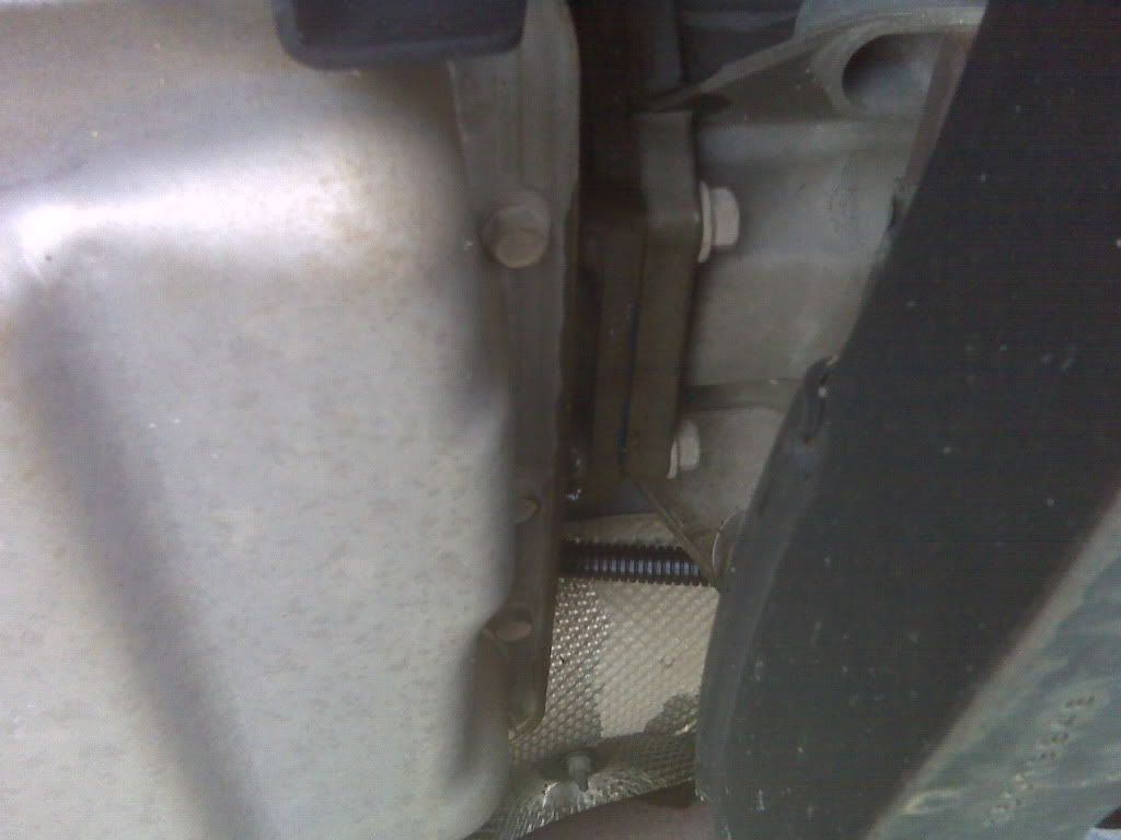

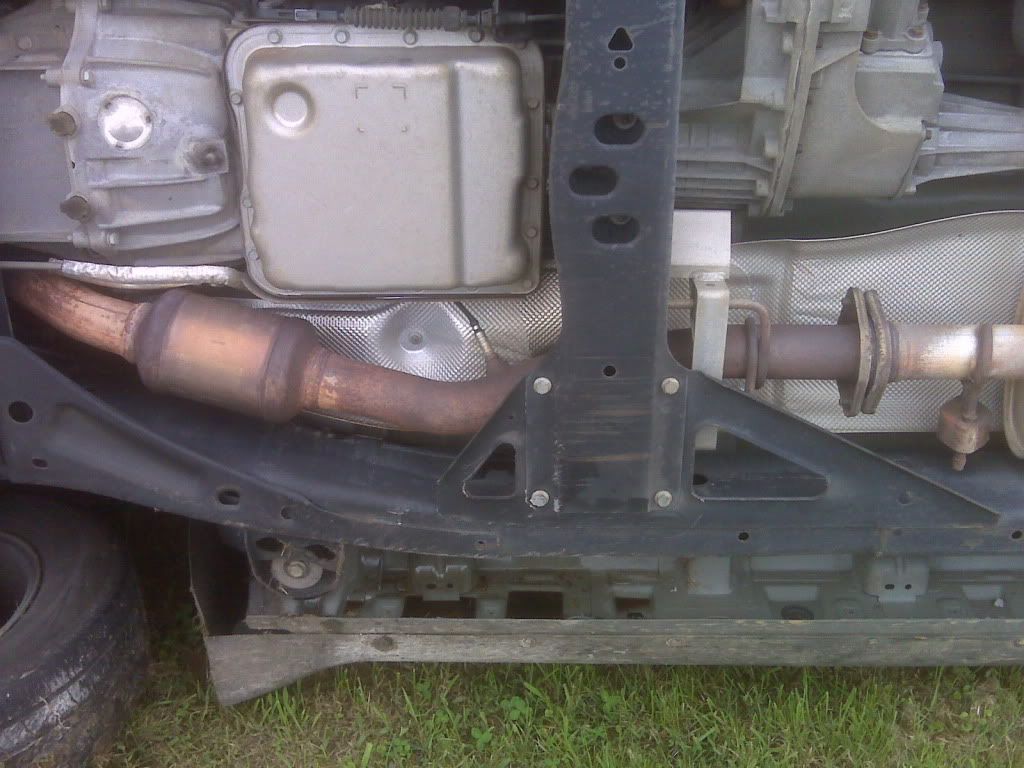

My wife had an accident in het Trailblazer a month ago. She overcorrected and spun and slide into someone's yard and put the Trailblazer on its side. I noticed when I came to get her, a lot of fluid had collected just below the transmission area. It's an 02 LTZ with 4 wheel drive. Today the shop is done with the repairs but they could not tell me where the fluid came from. Can you guys tell me what this is and is it ok to drive? Thanks.
Where I thought the fluid was coming from:

yeah it definitely looks like tranny fluid, i would run it through the gears while the engine is running to make sure that all the ports are filled up and the torque converter is full and then recheck , then take it around the block and then recheck again better to be safe than sorry. might just want to check the gear oil for the 4wd too

Id have to say that its just tranny fluid that got out from the vent tube
Hope everyone was alright
Hope the wife is alright. Looks like very old, almost burnt tranny fluid.

So I went to pick it up and put it in every gear and everything seem okay. But then I put it in A4WD and there was a loud noise when it engaged. It never made this before, so I left it there for them to check it out. I'm guessing the fluid was from the transfer case? Sorry for the ignorance, I am pretty knowlegable when it comes to cars, but I haven't worked too much with her car. I am always wrenching on mine (01 Audi S4).
*edit* Trailblazer has 144,xxx miles and we bought it when it had 110,xxx miles and I have not changed the transmission fluid, so I am not sure if it was every changed. :duh:

As for the leak it looks like either trans or transfer case fluid could have leaked out the vents and dribbled down. It's not like they could have broke but check both.

If it was transfer case fluid, it would be blue.
Definately old trans fluid. Drop that pan and change the filter, disconnect front cooler line and flush that old crap out.

I would get your transmission and all driveline fluids changed. That is simply transmission fluid that leaked out the vent pipe, but it definitely looks old.

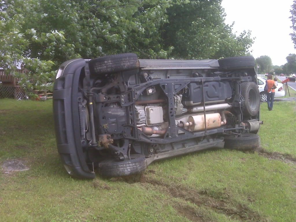

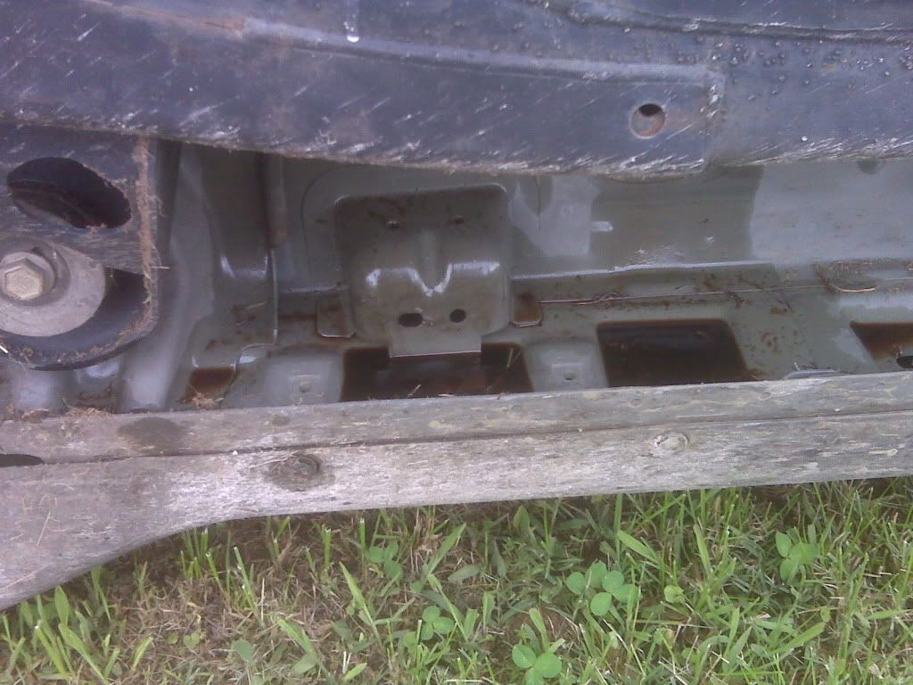

Couple of more pics and what it looked like when we rolled it back up right.
