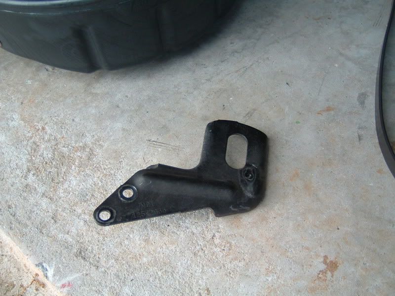

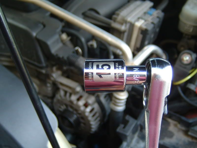

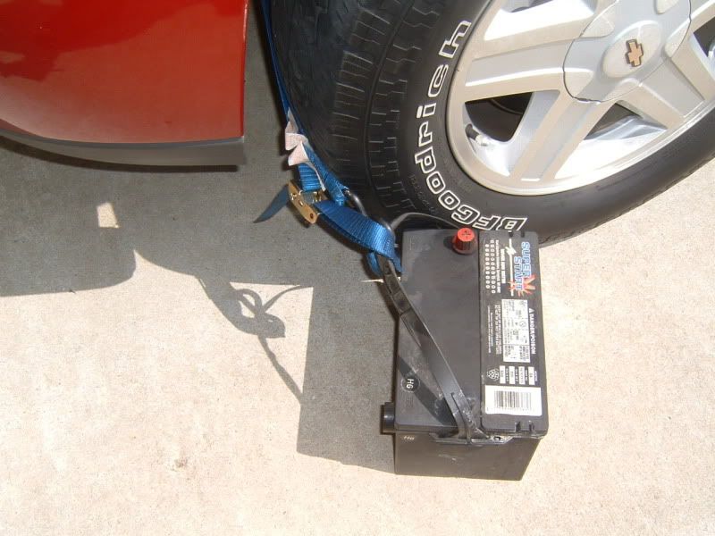

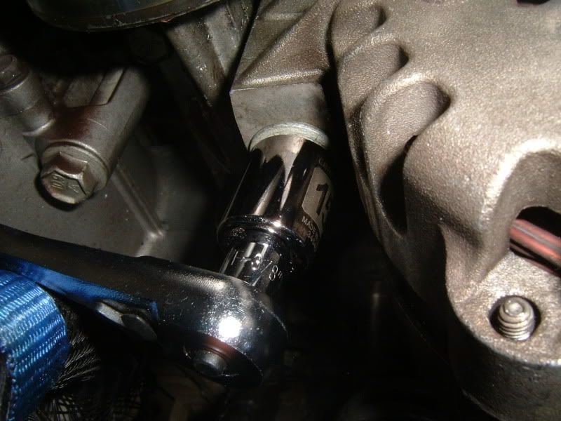

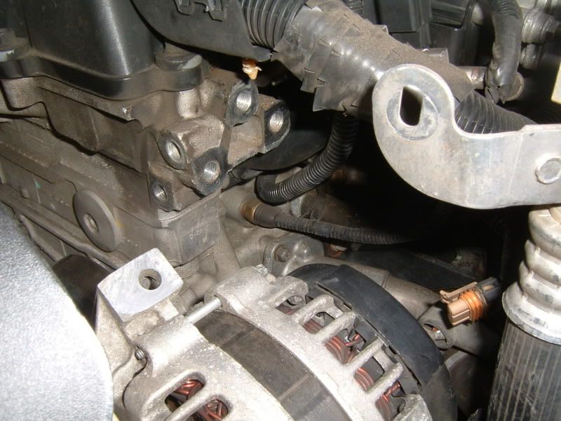

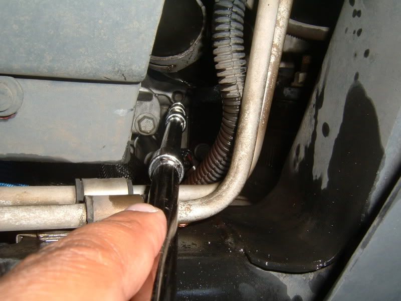

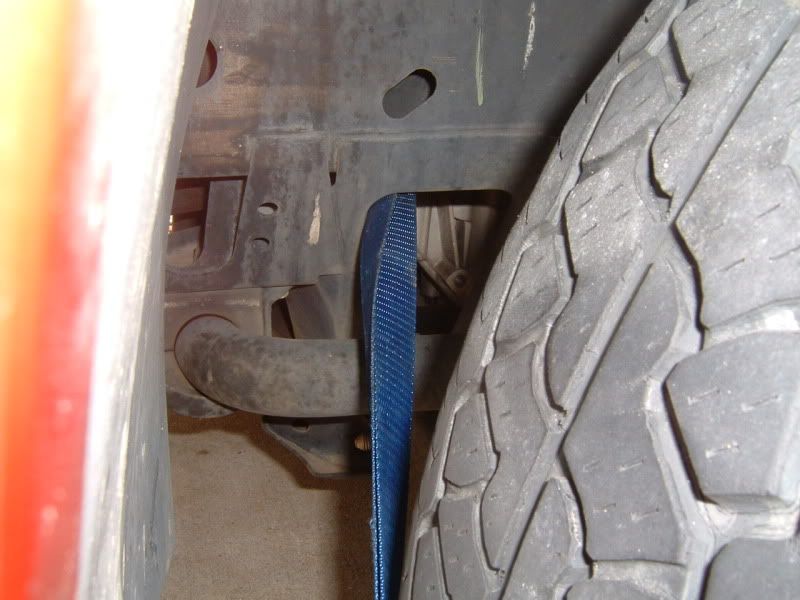

3 - HELPFUL TIP :thumbsup:to remove the alternator, I first removed the bracket, and then removed the two top alternator bolts. THEN, since I was working alone, I grabbed a tie down strap I had laying around, and wrapped it around the A/C hose that snakes in front of the bottom alternator bolt, and then fished the ends of the strap down through the left front wheel well. I pulled my battery, and used that to pull the strap just enough to keep the hose out of the way. From there, I could easily get to the bottom bolt. See pics!!
4 - Disconnect the wires from the back of the alternator, and then slide it/maneuver it to either pull it out, or in my case, move it enough to gain access to the thermostat, which should now be completely visible.
5 - at this point, it was easier for me to remove the thermostat while still connected to the hose. I removed the top bolt from above, and removed the bottom bolt through the wheelwell.

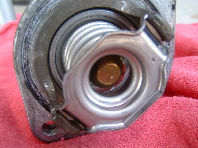

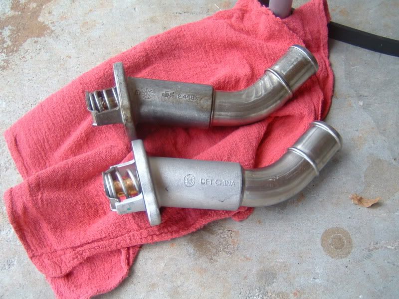

Be prepared for coolant to spill all over once you loosen and remove the t-stat. From here, I found it easier to turn the hose so I could remove the clamp and the old t-stat. Here is the old one... WIDE OPEN, just as expected!!
Old vs. new part. MADE IN CHINA.. on my Chevy!:hopeless

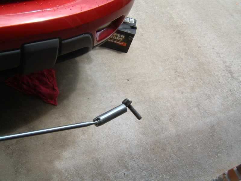

Putting everything back together was too not hard, but like everyone else, I dropped the bottom bolt when putting the new thermostat on. I finally figured out I could wiggle my hand in there and start the bolt by hand, then go through the wheel well again to tighten it.

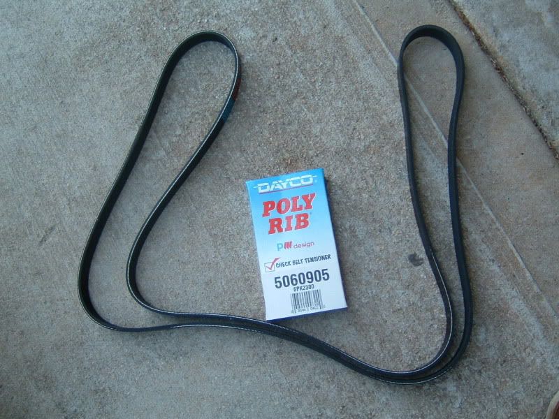

Here is the new serp belt. Make sure you get the right one. I have an EXT, and this one went on easily.

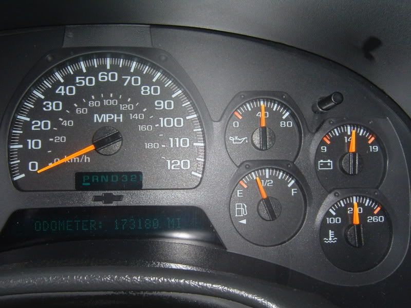

And here is my result! After a coolant drain and refill - No more SES light, and all the gauges look good... except the fuel gauge! haha.
