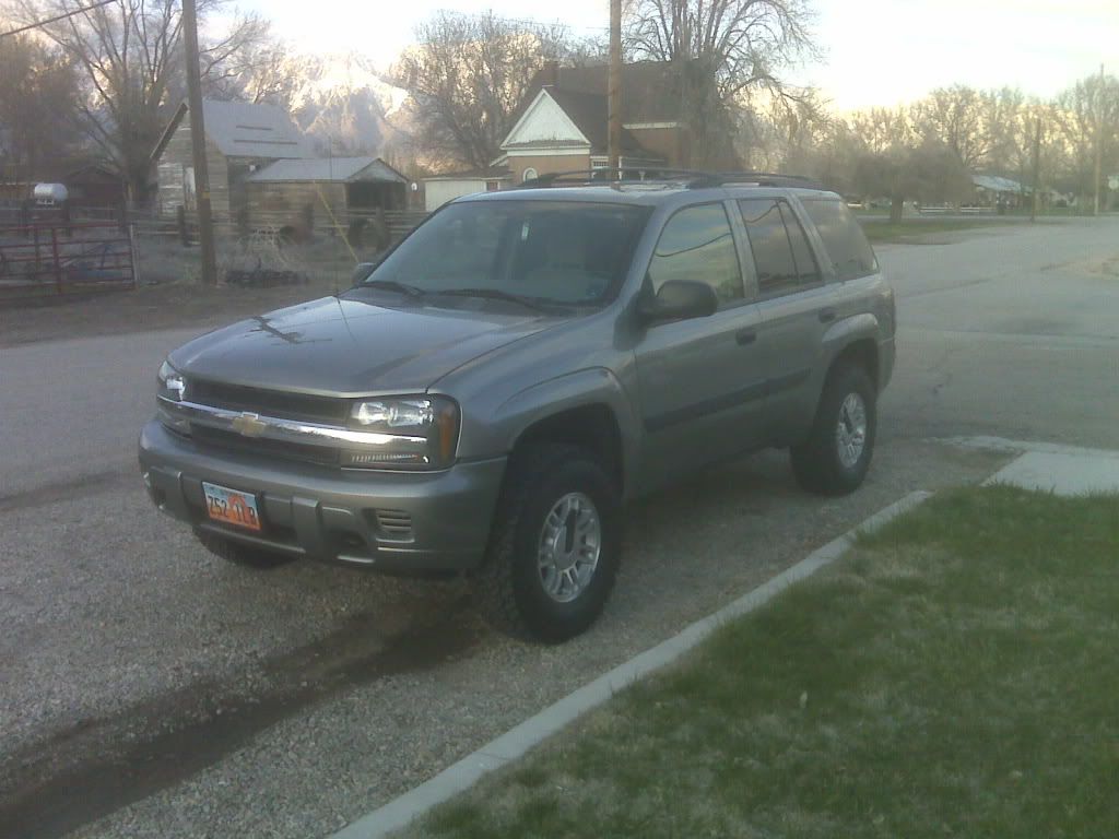

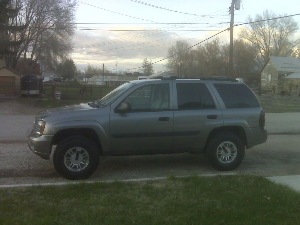

Everything is on!!! :woohoo::woohoo::woohoo:

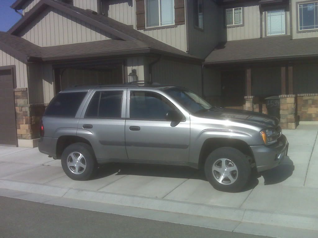

Before :
After the lift (no wheels/tires) :

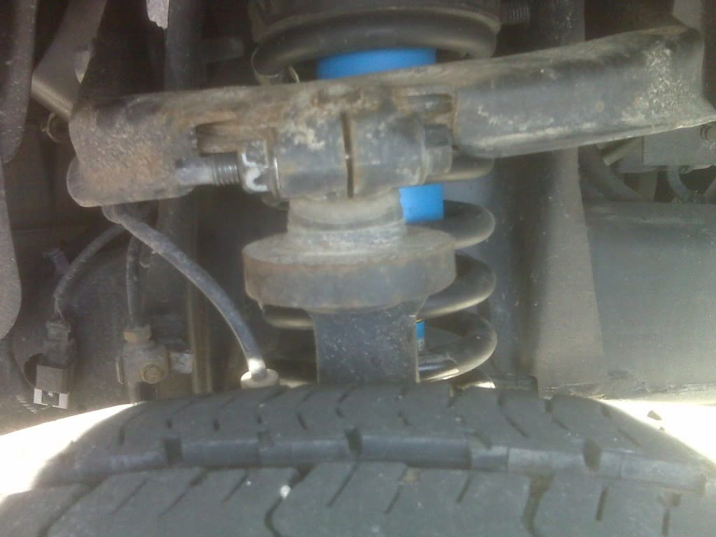

Mark's 2.5" Front Kit :

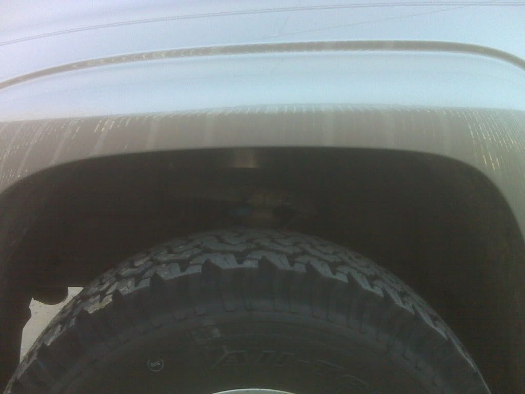

Space between upper control arm and stock tires :

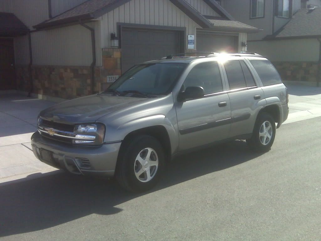

ALL DONE!!!!! :

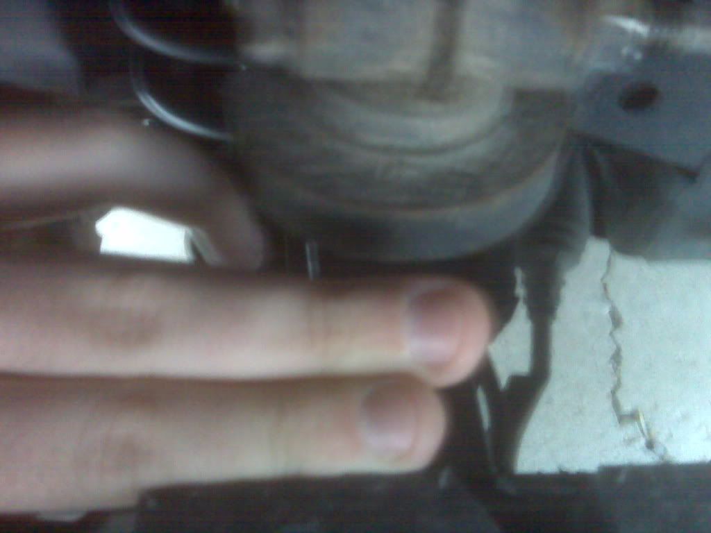

Front Tire Clearance :

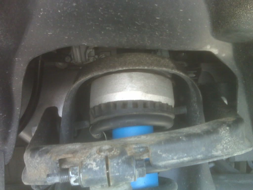

Front Upper Control Arm Clearance :

WHOA!!!!
What an improvement!!!:thumbsup::thumbsup:
Did everything go ok???
Most of all, are you satisfied?
i pride myself on customer satisfaction..
Did you take before and after measurements??
343 Posts

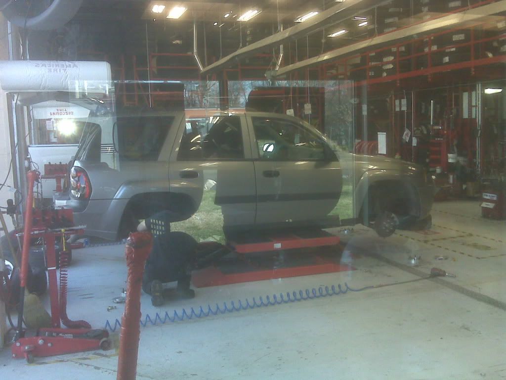

Everything went great! I ended up having a local shop do the complete install for me. By the time I would have gone out and bought the tools I would need, plus the time and the blood, sweat, and swearing, and gotten the alignment done, it was actually cheaper to have the shop do it for me!
Thanks to Mark for all the hard work he put into putting this kit together! And thanks to everyone for your advice and input!
I think it turned out great!!! :woot: This is how the GMT360 SHOULD have come from GM! I can tell the ride is not as "cushy" as it was, but it's still not bad! The mountains around here I like to play in are STILL getting snow, so it may be a month or two before I can really try it out.

So what are the details of everthing? Tire size? wheels spacers or not?
343 Posts
-Mark's 2.5" kit and Bilstein HD's in the front,
-Z71 shocks and springs in the rear,
-1.5" 6x5" to 6x5.5" wheel adapters (78.6 mm CB on the hub side, 100 mm CB on wheel side),
-Hummer H3 6-lug wheels
-BF Goodrich All Terrain T/A KO in 265/75/R16
-PCMforLESS Tuned PCM (Tune for 89 octane, tire size recal, #2 shift firmness, remove speed limiter, tuner's choice rev limiter, reduced torque management)
Mike's aluminum skid plate will be put on when I get some time.
I just put the tuned PCM in this morning, and holy &#^@ what a difference! I can definitely tell that they shifts are quicker and more firm than before! Having the torque management reduced is awesome! Power just pours out of the motor when asked, whether at a stop or doing 65 down the freeway! :woot:

hmmm hummer wheels huh? lol. looks great man. can't wait to change my front set up to that one.
2,968 Posts
looks nice.....the hummer wheels look awesome.....
such a great difference..

Sweet man, those H3 rims are really growing on me! With the lift and Z71 springs, BIG improvement! And a tune, geez man you went all out on this one!
