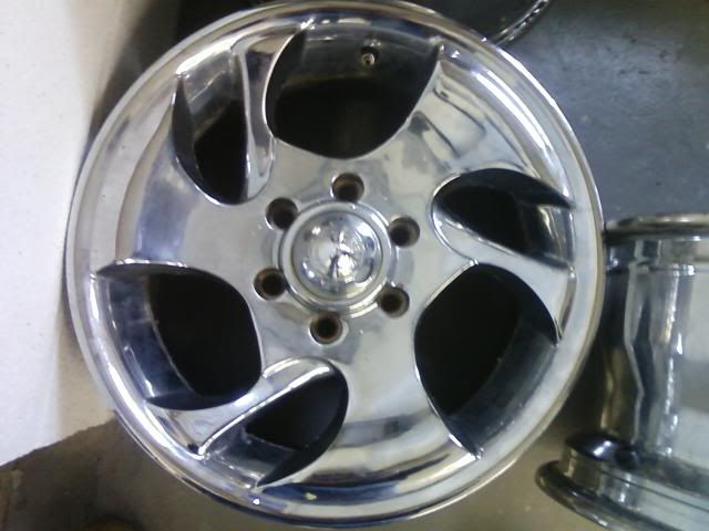

was wondering if anyone know what series this wheel is. all i know is that it is a american racing wheel and it is 17x8.
2004 gmc

I don't see any matches on the AR current product pictures. Maybe a discontinued one? A lot like Ventura, but not exactly.

i look on the ar page too nothing, i just thnk they are different and i like them. im just curious what they are. the guy wants a $100 for them. they wont fit his 03 v8 tb. mines a 04 v6 the rotors are different. he said he paid over $200 a wheel. the one center cap missing that why im trying to figure out what it is.
