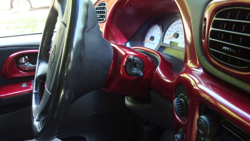

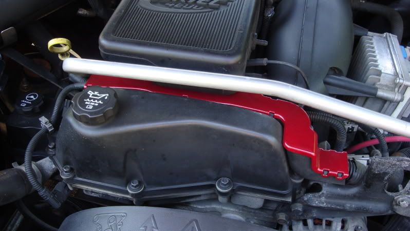

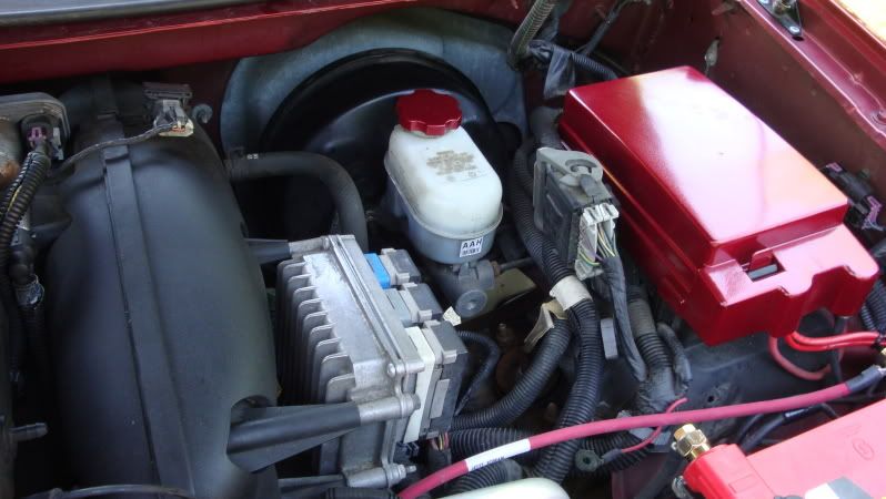

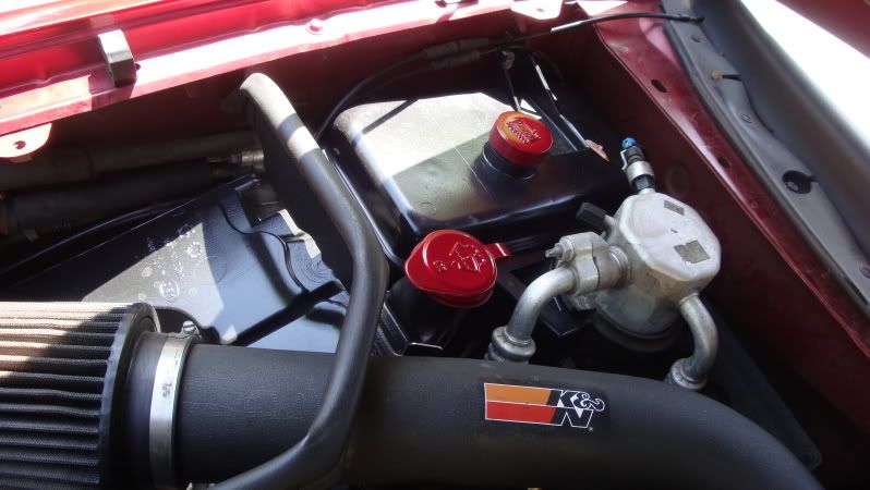

figured I would post a few update pics that I took a few minutes ago..
Re-installed glass handle and painted gloss black to match D pillars
smoothed and painted steering column covers (did it while I was replacing my ignition switch.)
painted some fluid caps after I painted the containers black and painted the wire harness cover

What's your secret to getting the interior panels so smooth? Do you just do a ton of sanding, or do you fill with something? I've been thinking about doing mine, but I'm put off by all that texture.
Used a disc sander attachment on the end of my cordless drill. 180 grit with light pressure and hand sanded the hard to reach spots.. then I smoothed it over with 320 and 400 grit.
