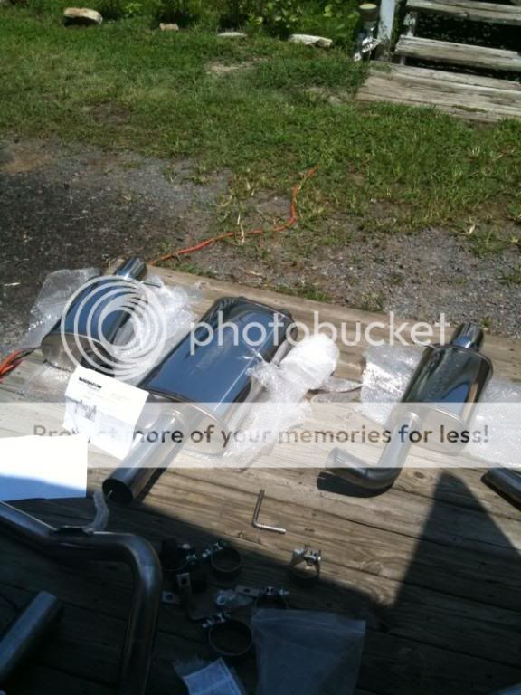

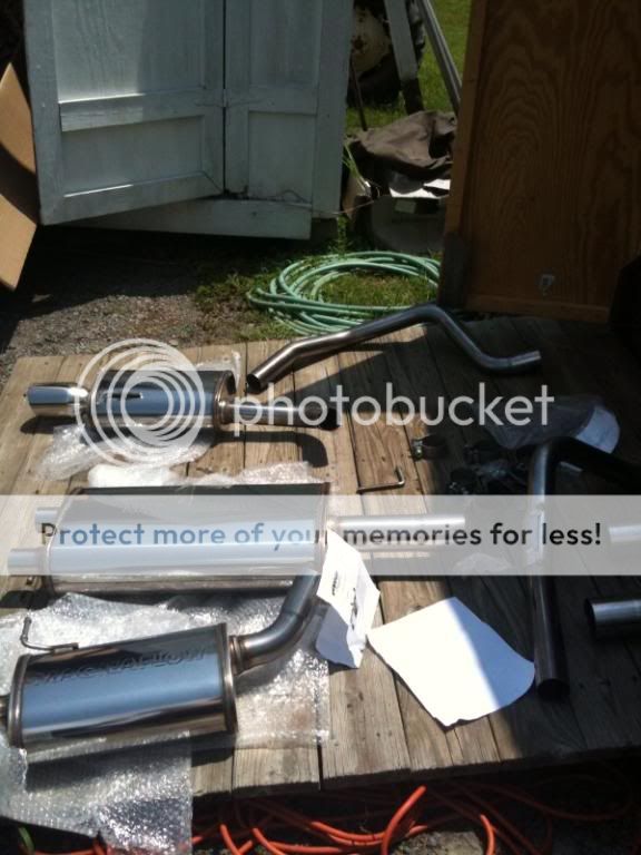

Parts laid out:

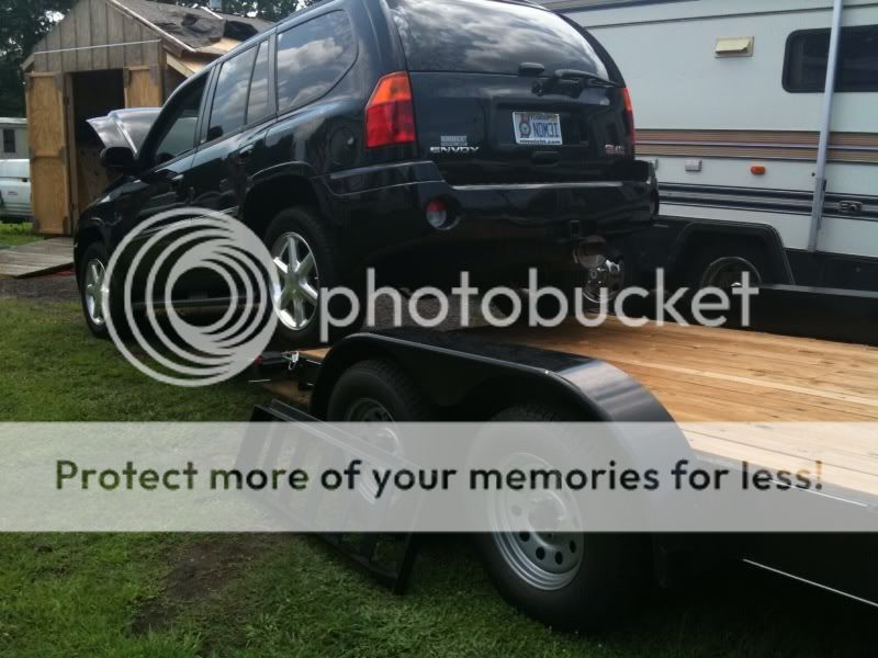

Custom Car Jack, We connected my dad's trailer to his Yukon XL, backed it up on there and removed the ramps... put jackstands underneath just incase it came unhitched... it didnt. The clearance was rediculous.

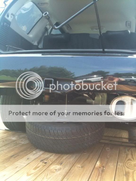

Dropped the Spare

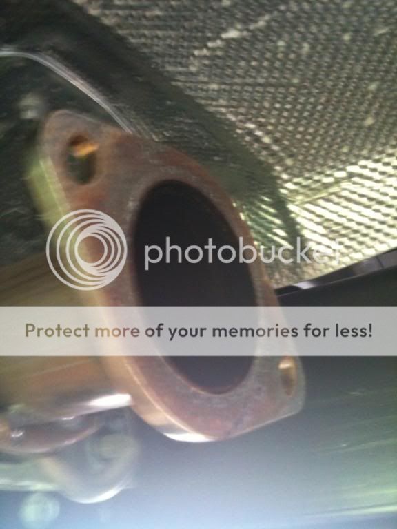

Disconnected the exhaust from the Cat:

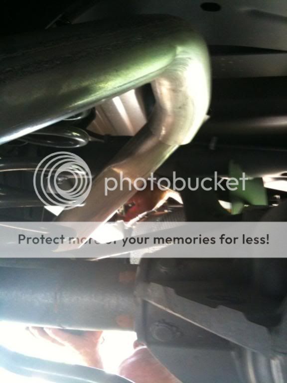

Made the first cut in the exhaust behind the rear axle like it said, but also cut before the rear axle to make it easier to remove:

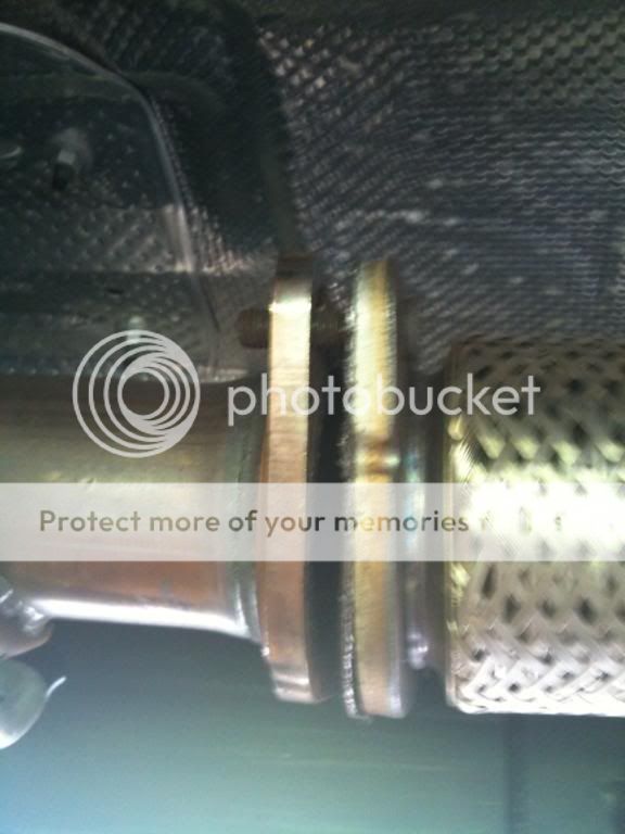

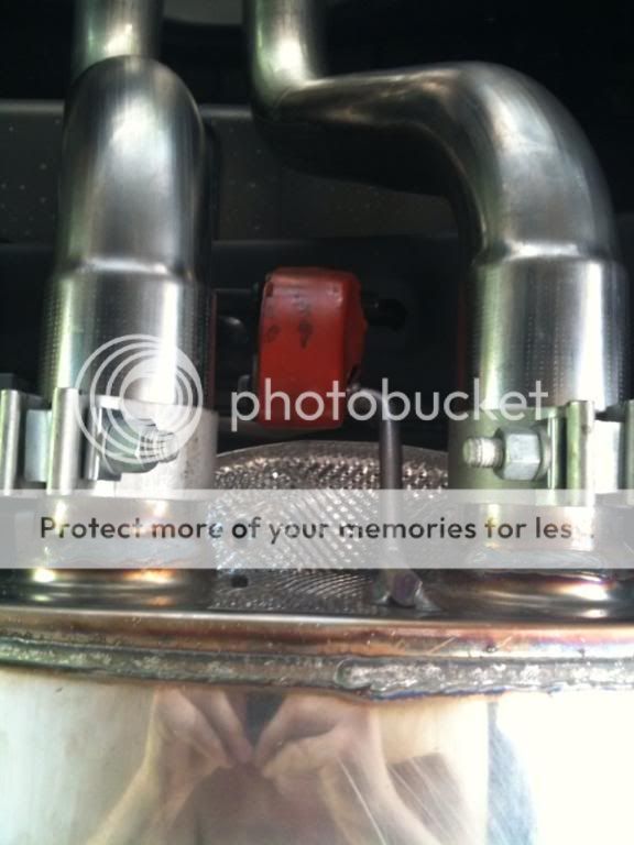

Put the 1-in, 2-out thing (I dont know the correct term) after the connection and started to hook up the pipes to go to the resonators:

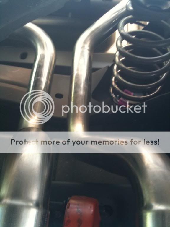

Picture of how the pipe clearance looks:

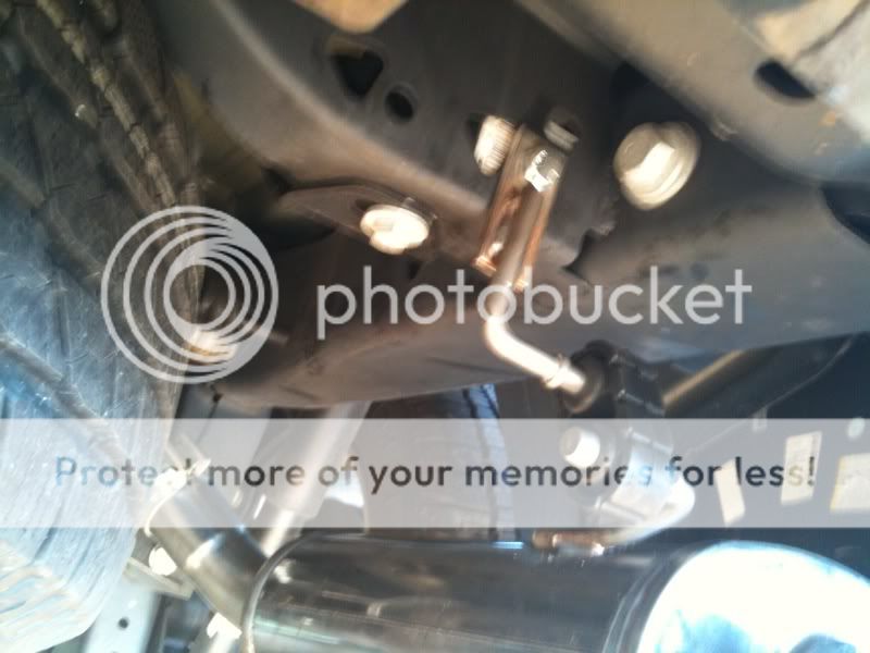

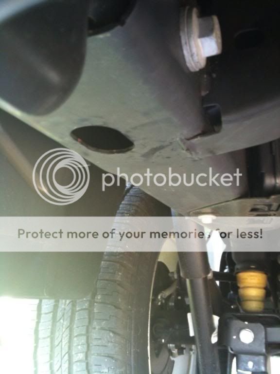

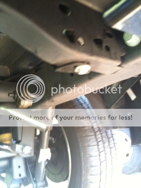

Ran the pipes back to where the resonators would go and figured out where to put the hangars. The passenger's side was easy, took me a minute to figure out where to put the driver's side hangar. The kit came with rectangular washers, my father and I opted to use some square ones that he had. In the back end of the frame there is a hole in the steel tube that the washer and nut went in to screw the hangar up into:

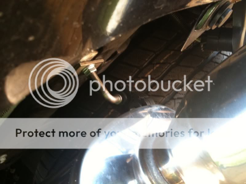

after I put the hangar in there and attached the pipe:
Passenger side I put the hangar in the round hole to the right:

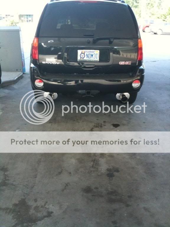

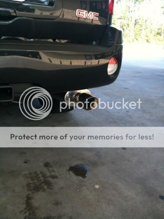

Tightened it up to torque and then drove around, rechecked and nothing moved... pictures of the finished product!

One thing that was curious is that we had to use the longer connector (From cat to 1-in, 2-out thing) even though I only have the Envoy, and not the XL. There was just no way that I was going to be able to get the exhaust to line up correctly. Luckily it came out well, we had to use our own bolts since we didnt get the bolts that came with it from the shorter connector. Used some stainless bolts that my dad had around, had to drill out the holes in the gasket, but not a big problem.

Looks Nice!are the back ,all the way up?look a little low but it could be the angle you took the pic.
Its just the angle... at least I hope that they arent low. Dunno though, even if they are low I like the way that I look so if I drop it will probably be the only time that Im worried about the clearance. Thanks for the insight though.
