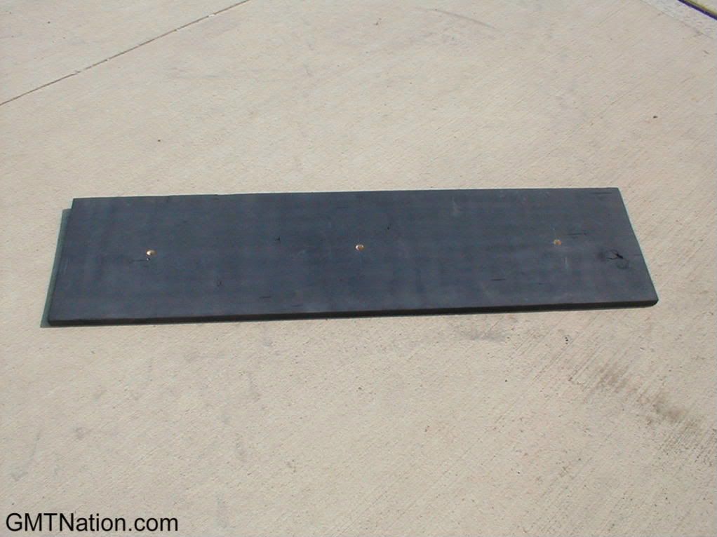

In my youth, I would have been competing with those members with 15s or 18s. I wanted a nice clean bass sound with a neat install and the ability to keep most of my cargo area. So began my project: Phase I
Materials: 3/4" board, 44"x11" ,black material,spray adheasive,black spray paint,misc. hardware
I painted the board because I wasn't sure how well the spray adheasive would stick to bare wood. (and in case you could see through the material) Then drilled holes to match the cargo tiedown locations

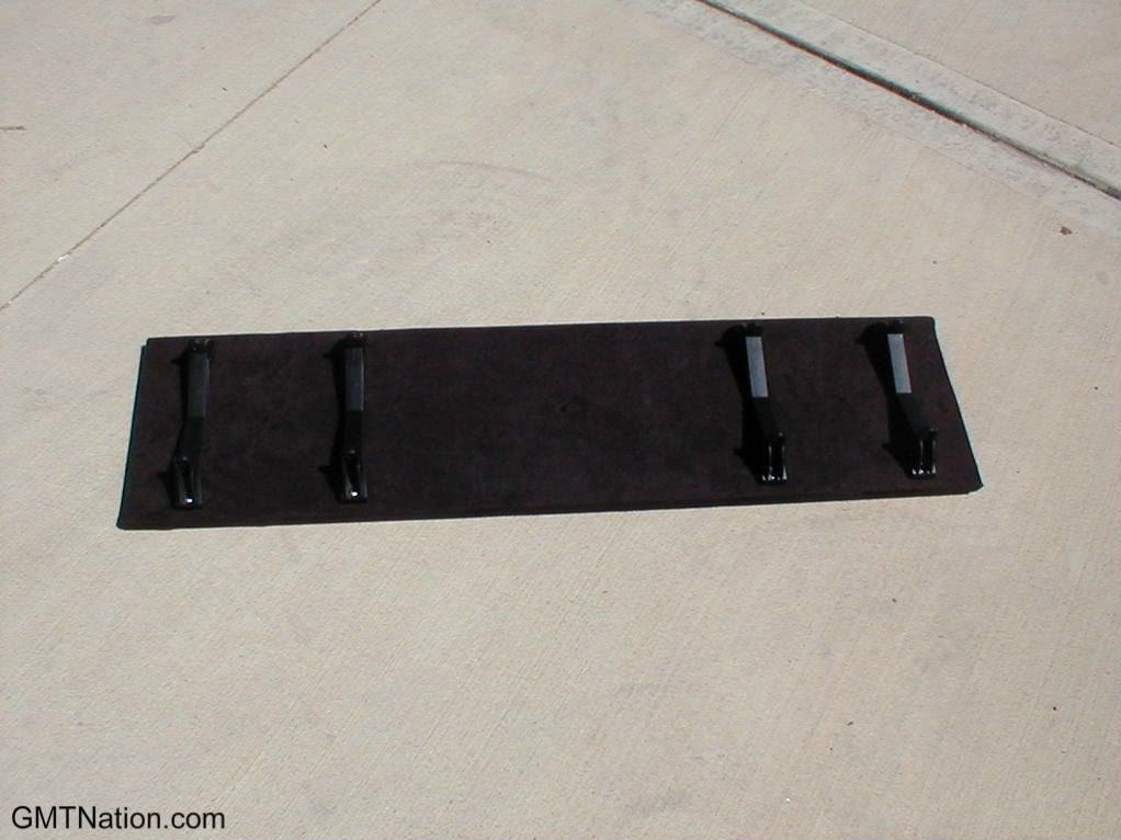

Then glued the material to the board and mounted the speaker mounts
Next, bolt the board down using the existing threaded holes
And finally, mount the speakers. Notice how much cargo area is still available and the fact that the cover still fits
Now, I realize that I won't be winning any high decible compititions, but there will be plenty of bass and I can still carry stuff.
