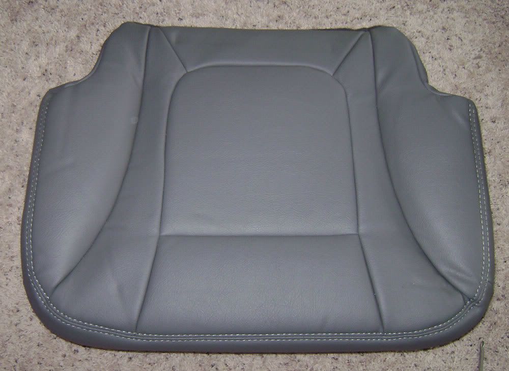

I found an ebay deal on DK Schwiezer italian leather for my 03 TB EXT. Couldn't pass it up. They are now a division of Katzkins, if you believe everything you read on the internet. Anyway, full leather, heavily padded, and EVERY detail of construction matched the OEM fabric. The quality is just outstanding.
Here are the results of 15 hours of work.
Want to know how? Then read on, but first let me say, I knew nothing about upholstery before this but I can't resist a challenge. Estimates I saw (again on the interent) said over 10 hours and not for the faint-hearted. Turns out they were right. 15 hours, lots of little cuts on the hands, sore fingers, and a result that makes the car geeks at work think you are quite gifted. You get it all with this project. The project takes basic hand tools: sockets, screwdrivers, a couple different Torx sockets, etc. It also requires a set of hog ring plieres and a box of hog rings. I bought these at the local Farm & Home Store. Less than $10 for pliers and rings. There was only one size pliers, but 3 sizes of rings. I used the #2 rings, which are the middle of 3 (obviously), but the smaller #1 would have worked well. The store was out of #1 rings. Pay attention to how things come apart so you know how it all goes back together.

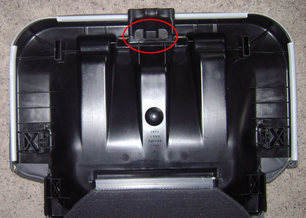

Third row seat cushion has two bolts holding it in
Remove those and the bottom cushion comes right out. Take that over to a table (covered in a lovely plaid quilt). Turn it upside down and remove the plastic handle shown below.

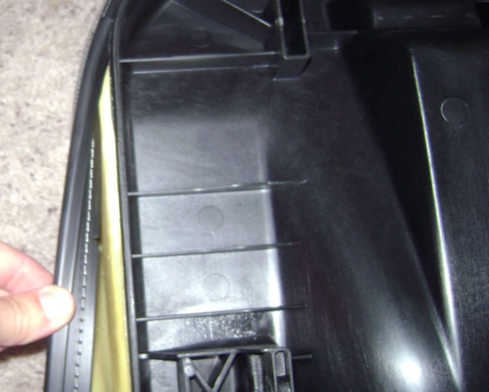

Then you will see plastic j-shaped channels that hold the fabric to the plastic

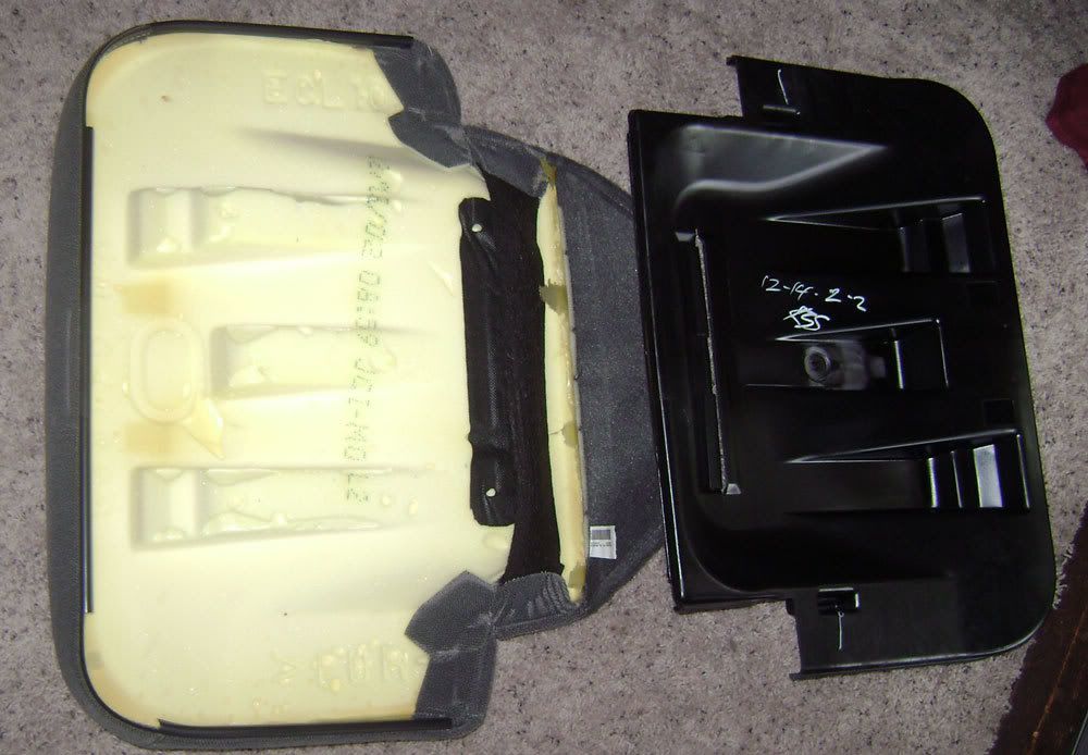

Remove the j channel from the seat bottom plastic and then you can fold the plastic away. Remove the last j channel from the plastic bottom.

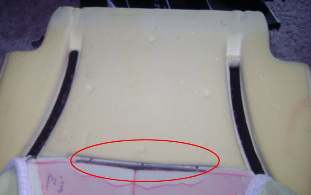

Now turn it over and start turning the fabric inside out until you get to heavy duty hook and loop and strips with hog rings attached.
Velcro is easy enough, just separate the two parts. The hog rings...well... they are pretty tuff. I have a medium size pair of cutters and they were hard to cut. I think a large set or stronger hands would have helped. I had neither! You cut the hog rings, then I used needlenose pliers to remove the two pieces. I threw them away ASAP. Didn't want them near the new leather! Here is what I was down to.
Next, line up the new leather and install the new hog rings. That part is easy. Just make sure that you are only putting those rings through the flap and around the steel in the cushion. I had this fear of putting a ring through the front...that would be bad!
Now, reverse the process and put the seat back together with the leather. Stretch those j channels around, stop to eat you microwave sausage biscuits and admire your work!

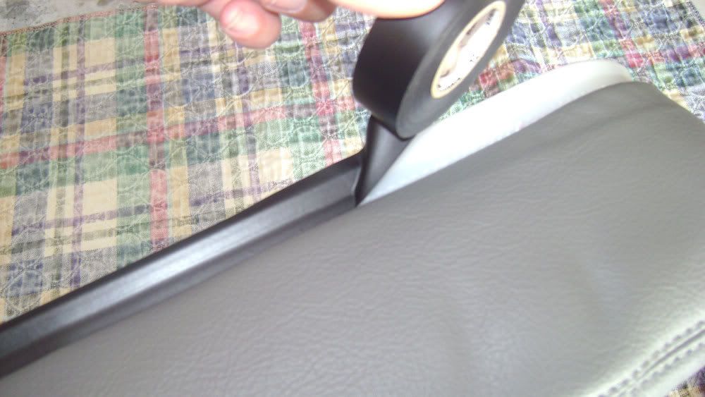

Not sure why, but the j channel trim on the new seats was white, and it looked ridiculous in the truck, so I put black electric tape over it. Now it looks right.

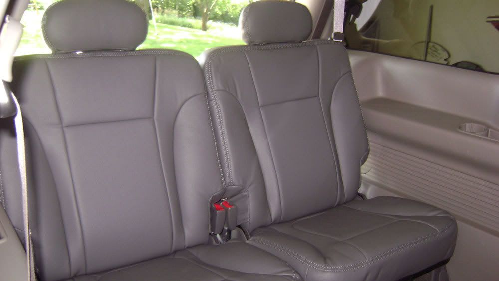

Repeat for the other side and you now have two seat cushions done. Don't look at the clock or you will be afraid to continue...

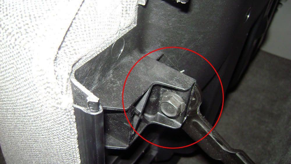

Ooops, put that seat back up! Now go to the back. See those bolts there? Take them out.
Then you can remove the j channel from that bar and fold the seat back down. Now separate the j channel at the bottom of the seat back and fold the seat back up. Ridiculous, I know... At this point, I would like to say that I have no idea if j channel is called j channel or not. That's just what it looks like so I make it up as I go. Slide the elastic strap through the slot in the seat cover.

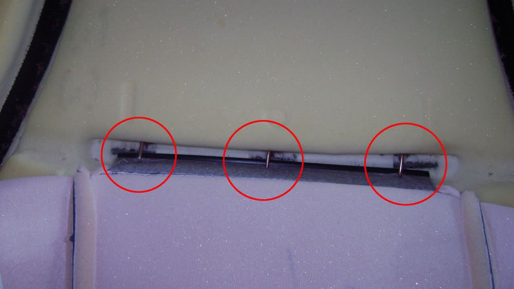

Then you get to these hog rings. Remove them.

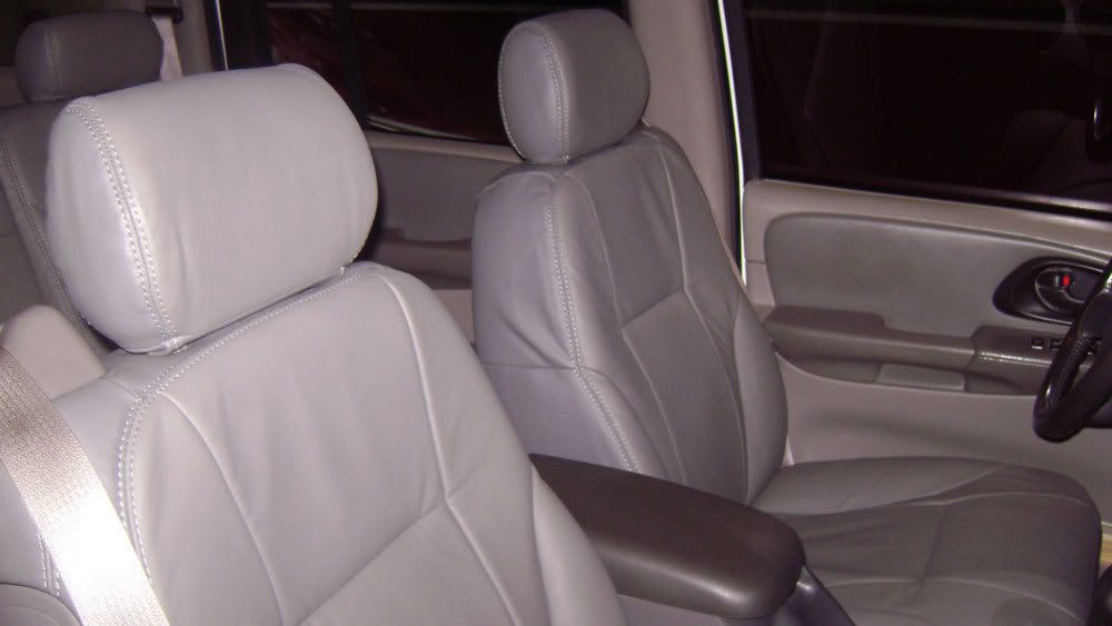

And you are done! Enjoy...smells and feels so nice. Best $350 and 15 hours I have spent. My wife has me looking to do it to her car next.
