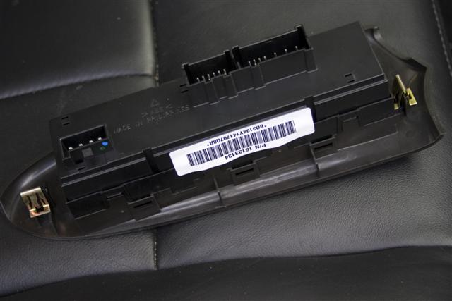

Here’s a pic of the door switches showing what type of clips hold it in. No worries – just lift it out!

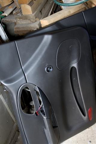

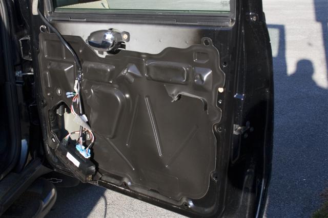

A pic of the removed door panel.

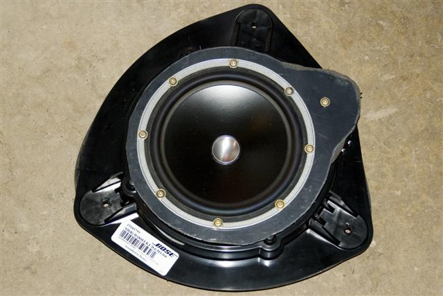

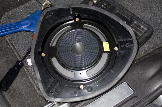

This is the front door speaker of a Bose Premium system. Strange looking 8” woofer. Tweeters are in the dash. (I left them there – they still operate the chimes & warnings)

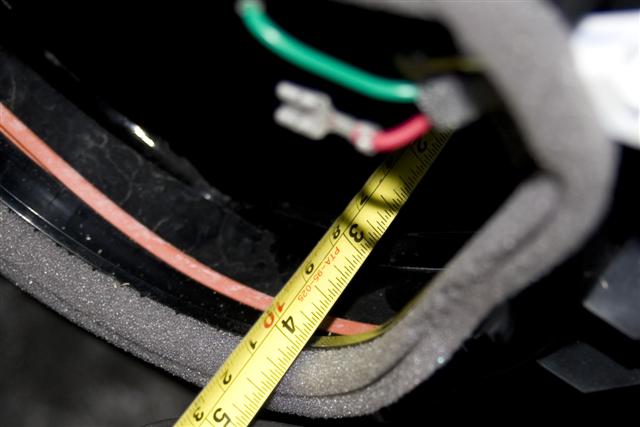

Close as I could figure – I had about 3&7/8ths” clearance.

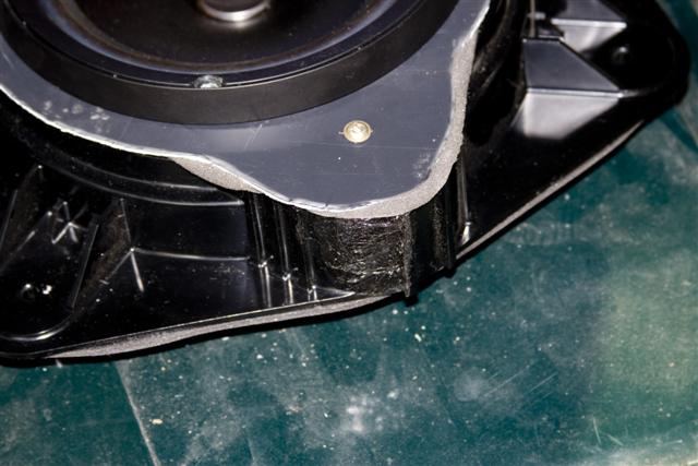

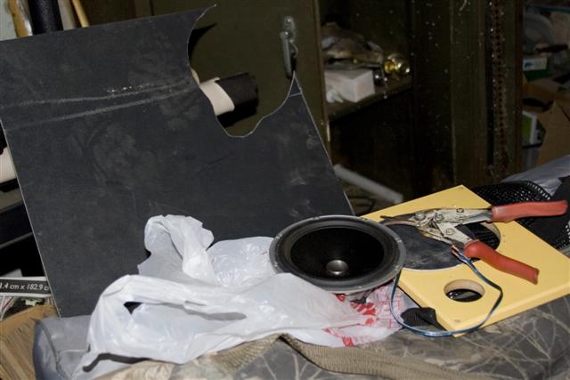

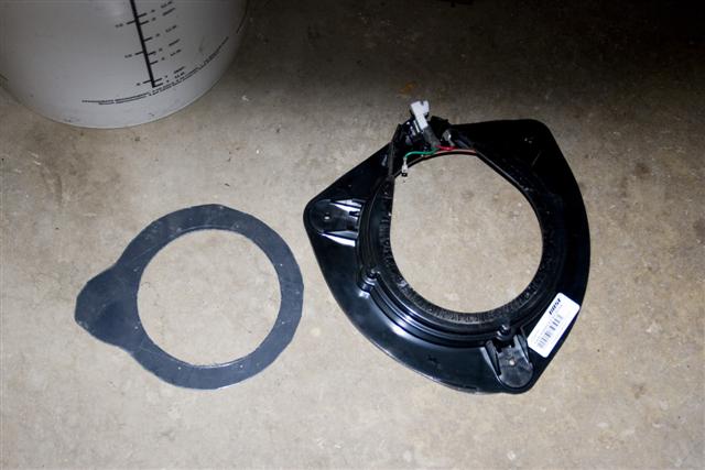

Removed the woofer and cut a cover out of some extra plastic I had.
Filled in where the wires were (with part of a spray can lid and silicone!!).
Of course, a picture from the back!

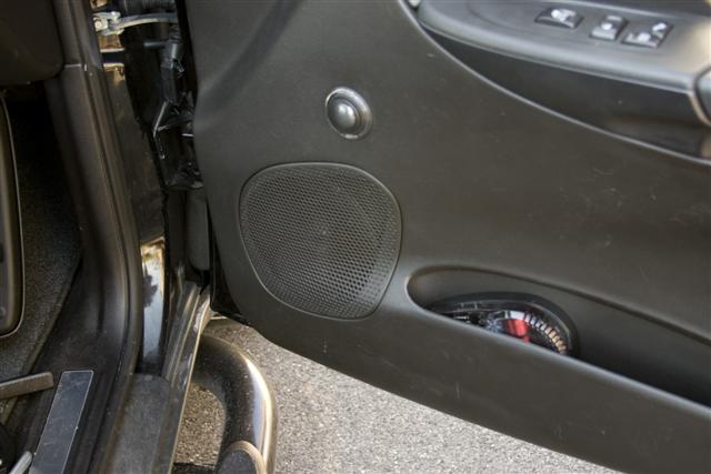

Drilled holes for the tweeters. Actually, if you look close – you can see I changed the contour of the door panel. I didn’t like the way they would’ve pointed down so I heated the door up (slowly and carefully) and when it was slightly soft - used a can the same size as my tweeter mount and applied pressure till it cooled. Nothing drastic – just to help a little.

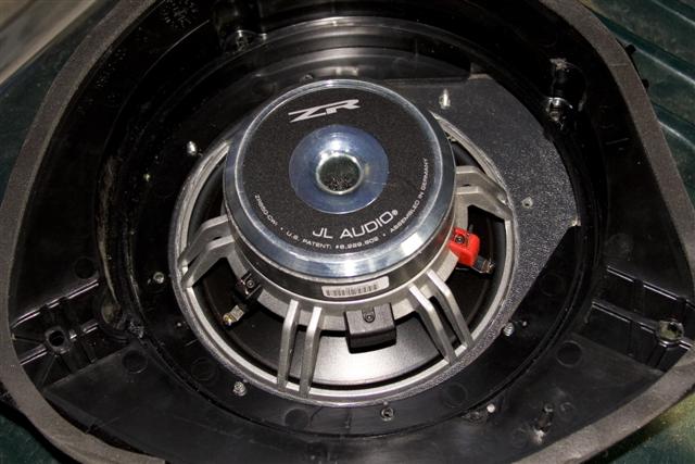

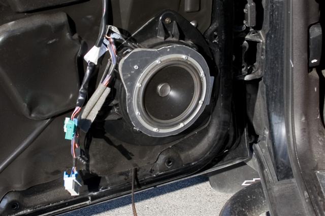

Installed. Not sure what I’m going to do with the crossovers – they’re there for now!
It was a lot of work – but I enjoy that stuff and the sound is sooo much better!:excited:

The door speakers - people call them 8's - I have them in the basement and can give you the measurement of the bolt circle if you want. I made that adapter and put 6&1/2's in. I didn't really look around if anybody makes a good 8 to put in.
I didn't have dash apart so I don't know what size they are. There was a thread asking about that this week - not sure if they got a definitive answer or not.
A word of caution - the foam around the speaker (surround?) was hitting the factory 'grill' a lot. I had to modify it to get some clearance - I don't think it's hitting any more. I know Andrew (may03lt) had the same trouble. The factory speakers were reverse mounted so they didn't have to have the clearance. You'll either have to modify the grill or I was thinking perhaps I could have mounted the speaker behind the 'box' instead of from the outside - I'm not sure. For the way Andrews and mine were touching the grills, I can't see that any speaker in it's place wouldn't have. Maybe others that replaced theirs can chime in about their solution.
