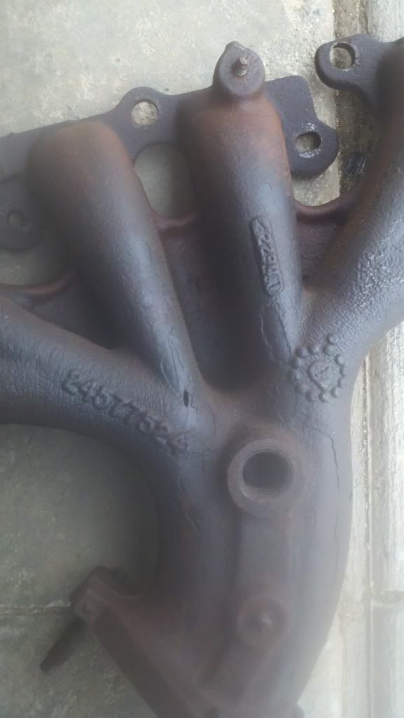

So I just got done swapping mine out! I didn't break any bolts, or really have any issues. I soaked the 11 manifold bolts in PB blaster and the 3 flange nuts as well. I let that sit overnight, then I broke the torque on all the bolts and backed them out about two turns, I then soaked them with some more PB bLaster and let them sit overnight. The next day I took them all out and had no issues what soever. I had to use a breaker bar with the flange nuts, but other then that I had no issues there as well. I got my flange donut gasket from autozone for 8 bucks and I got the bolts with thread locker on them already from the dealership for $2.28 a bolt. I bought the manifold off of amazon for $117. Its really not a super hard job, if you can turn a wrench, you can do this. This was my first time replacing one.
Here is what mine looked like when I got it out
