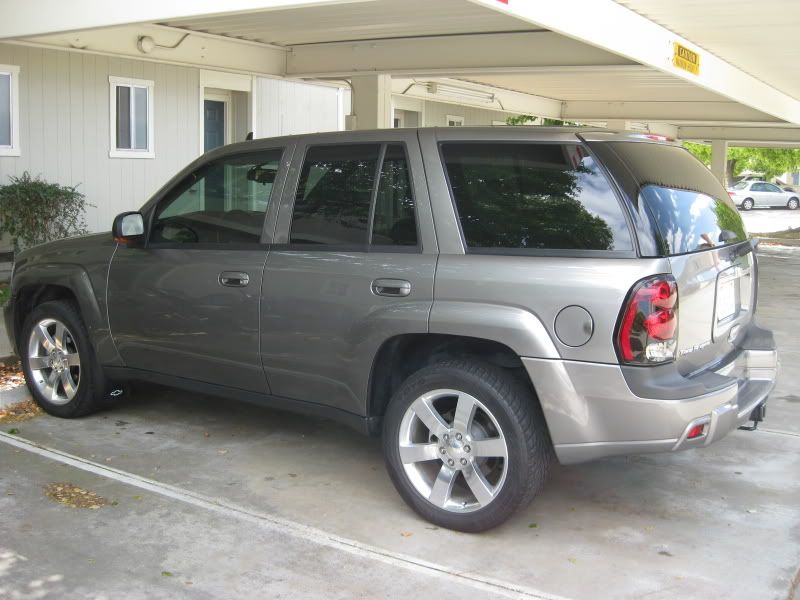

Well so i finally decided to do the de-rack mod on my trailblazer. I first tried the cap style and i didint like how it came out. So then i tried using the stock bolts and although i think it was not as obvious as the caps, still stook out a bit even with the washers cut off. So i finally decided to do what a member did here already and bought set screws :thumbsup: This came out the best, all you have now is that little nub sticking out the roof and nothing more. It is berely noticeble and the truck looks clean. I also felt taking off the running boards cleaned the sides up a bit as well. Enjoy!

Looks good. I need to do my rack one of these days.

yeah i was not planning on doing it, but i decided to see how it looks for the heck of it, and it looks a lot better. I also noticed it is a little quieter on the freeway. :woot:

Where did you get the set screws and what size? Looks very good!!:thumbsup:

yes the running boards are a little heavy. The set screws i bought at osh and the size are 6MM metric written out like this 6mm x 20 x1.00 They were about 1.10 each and are about 1 inch long.

When installing the set screw i put a dab of clear silicone in the hole, then i screw in the set screw about a 1/16'' to 1/18'' under the nub so i can have some room for some more silicone on the top to seal it and cover it. Let that dry and took my touch-up paint and painted it all. Came out great.

Thanks for the warning, I actually got the TSB work done on the sides from the rock chips. I did notice that after i put on the mud flaps i didn't get any more rock chips but the damage was done already. So i had the paint work dont to it, then i had the running boards added protection but i don't like the look of it. I will be adding the 3M clear protection over the sides if i notice it starting to chip again. Thanks!

Some of you were asking for a picture of the finished product of the roof nubs done with set screws and silicone, then touched up and here it is.
