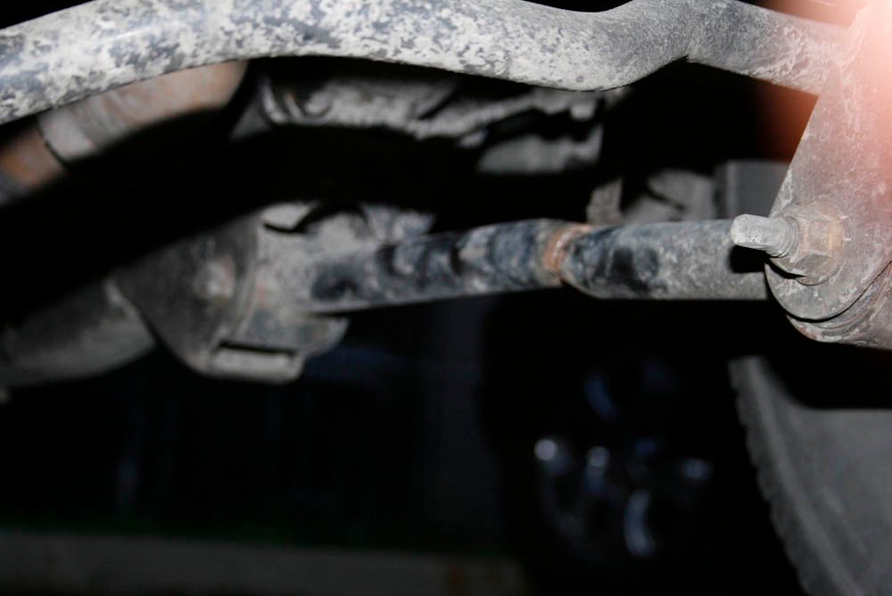

here is the best pic i can get for now, dont mind the blurryness, it was dark and hard to focus lol
HOLY CRAP! How did you manage that!?
They're about $120 from discount suppliers like parts4chevys.com. $170 list. You can check Ebay or the junkyards. Any idea how or when it broke? That's extraordinary!

Passenger side is GM# 15069840 if I'm reading the compnine.com data base properly. It's item #6 in the drawing I posted. Lower control arm.
