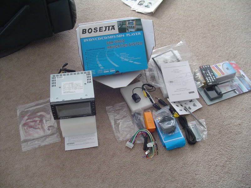

Just got a new radio a gps bosejit nav dvd radio

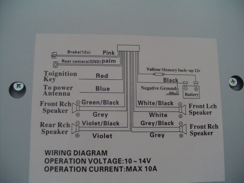

The gmos 04 attached to my new radio says to connect the mute line
ie
1. Connect the Brown wire to the mute wire of the aftermarket radio.
cant find a mute line
2. Connect the Green wire to the parking brake wire of the aftermarket radio.
ok
3. Connect the Blue/Pink wire to the VSS or speed sense wire of the aftermarket radio. can t find a vss wire
4. Connect the Green/Purple wire to the reverse wire of the aftermarket radio.
ok

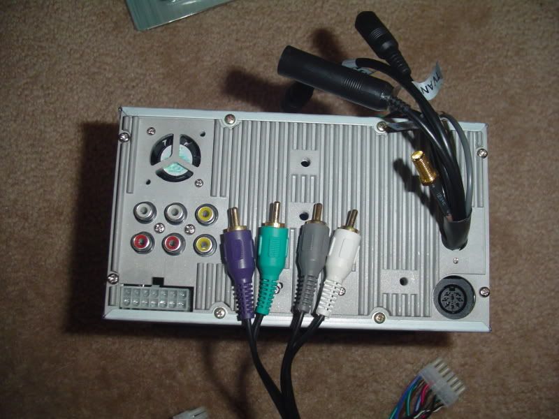

4. The white RCA goes to the left front RCA output of the radio.
5. The gray RCA goes to the front right RCA output of the radio.
6. The green RCA goes to the left rear RCA output of the radio.
7. The purple RCA goes to the right rear RCA output of the radio.
I have these connectors from the gmos 4 as bare wires on the bosejit radio but there are also 6 rca jacks in the back are these the same ?
lookie
and what is that connector on the right bottom ? fits old keyboard connectors
