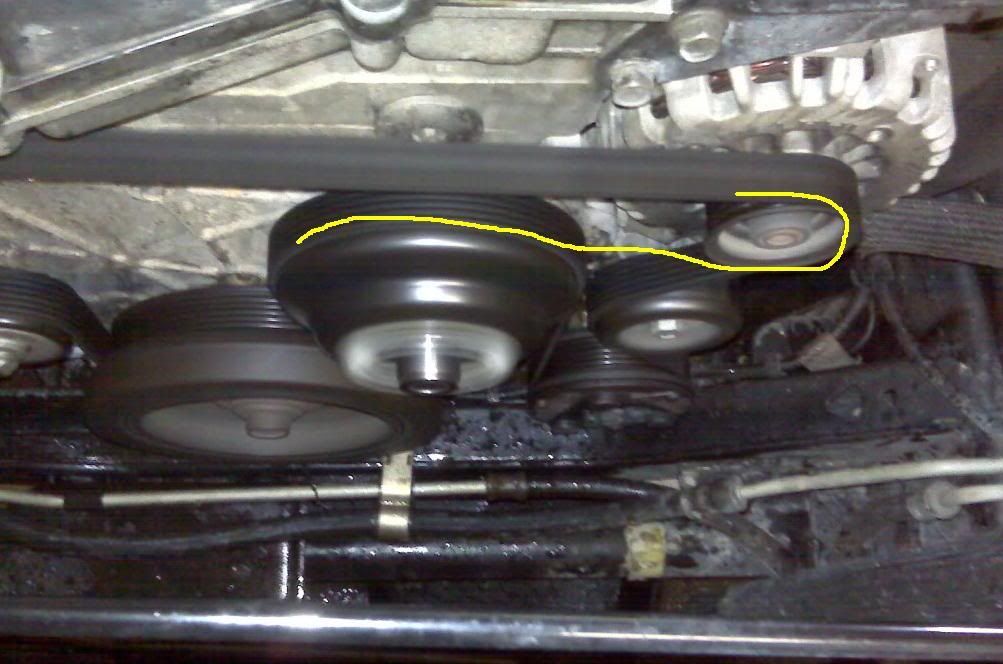

How did you route the belt? I tried going around the alternator to the fan then the crank but the belt is to long. What am I missing?

NAPA. I returned the belt and ordered the right bearing from bearings direct. I don't remember the part number. Sorry.
